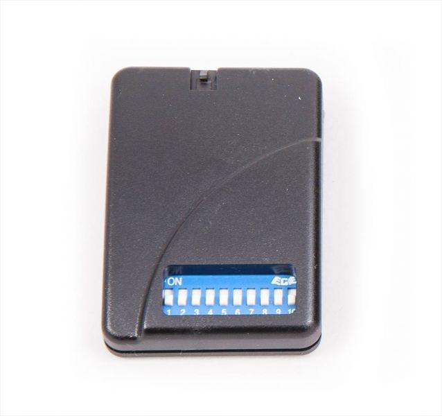

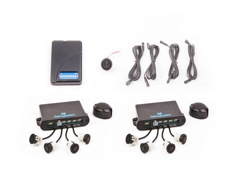

    Hi,
    Thanks for your reply. I only have that GT Alarm module.
    But there's some info's about this module:
    This is the kit they installed on car:
    This is the Park view Module GT alarm:
    Hope that can help.
    Best Regards,
    Chirag Geiantilal
    '06 - Volkswagen Passat 3C 2.0 TDI Highline - 2009 - 2017
    '12 - Volkswagen Golf VII 1.6 TDI Confortline - 2015 - ...
  9. #1349
    1,813
    cgentil: OK - as I suspected, the "GT Alarm module" is directly wired into the CAN bus.
    Try entering "10", or "76" into the "Direct Entry" box at the bottom of the Select Control Module screen (see below)
    Failing this - and I'm guessing again, but the new module must be thieving some of the CAN messages that would normally be the responsibility of the OEM module (i.e. J791). Clearly this has the side-effect of masking the module @ address hex10 from CAN Gateway module when it's performing the Diagnostic function. Very strange behavior, but probably something that can be best resolved through the GT alarm module manufacturer IMO. Non OEM - third party products can be tricky to fault-find (if this is indeed a fault- which it might not be)!
