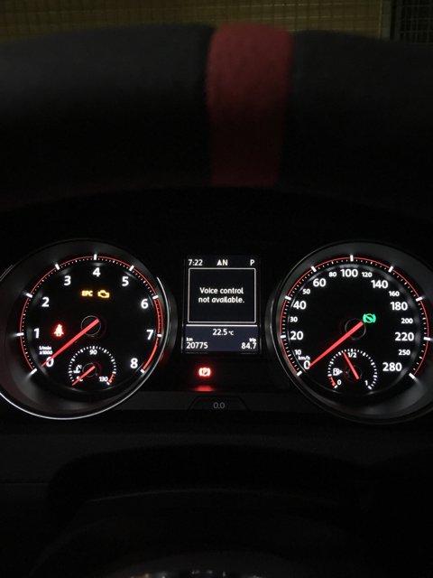

    Basik: OK, that's why you were getting the error message to install the activation code - because the 5F module was told that VC was installed (via the code-string setting), but the activation code wasn't entered - makes sense now!
    Strange that you still don't have mute after deactivating the Byte/Bit - have you tried resetting the MIBB unit after the change ? It's done like this:
    With the MIB unit turned-on press down the ON/OFF knob until the MIB unit switches-off AND keep holding the ON/OFF knob down until the unit turns-on again (about 10 seconds).
    Then try the VC button(s) again
    Yeah ok so I tried that and nothing changed still get the error message.
    Once I made it deactivated this error has now gone but still get the top message.
    This is after the MIB reset as well.

    Does it look like I'm out of luck?

    Bassik- I never like to give-up without a solution, but I'm running out of options.
    I'm trying to understand why this problem has arisen on your car? The fact that the default value for Byte 24 was set is unusual for a mk7 that came factory fitted without VC. Plus, I consider myself to be fairly active in the mk7 forums and your problem is relatively unique. What's the history of the car?
    PS: Long shot - but try resetting to factory settings through the MENU option

    Honestly couldn't tell you the history. It's the 40th Years ED and was bought only 2 weeks ago. I got the OBDeleven straight away. Could it be that it's the 40th?
    If I have the option to activate with a code from VW does that mean that I have the VC installed but just not activated, thus meaning I do have it installed from factory.
    I like your determination because from reading on several forums I can confirm owners do in fact have the VC functioning as a mute button.
