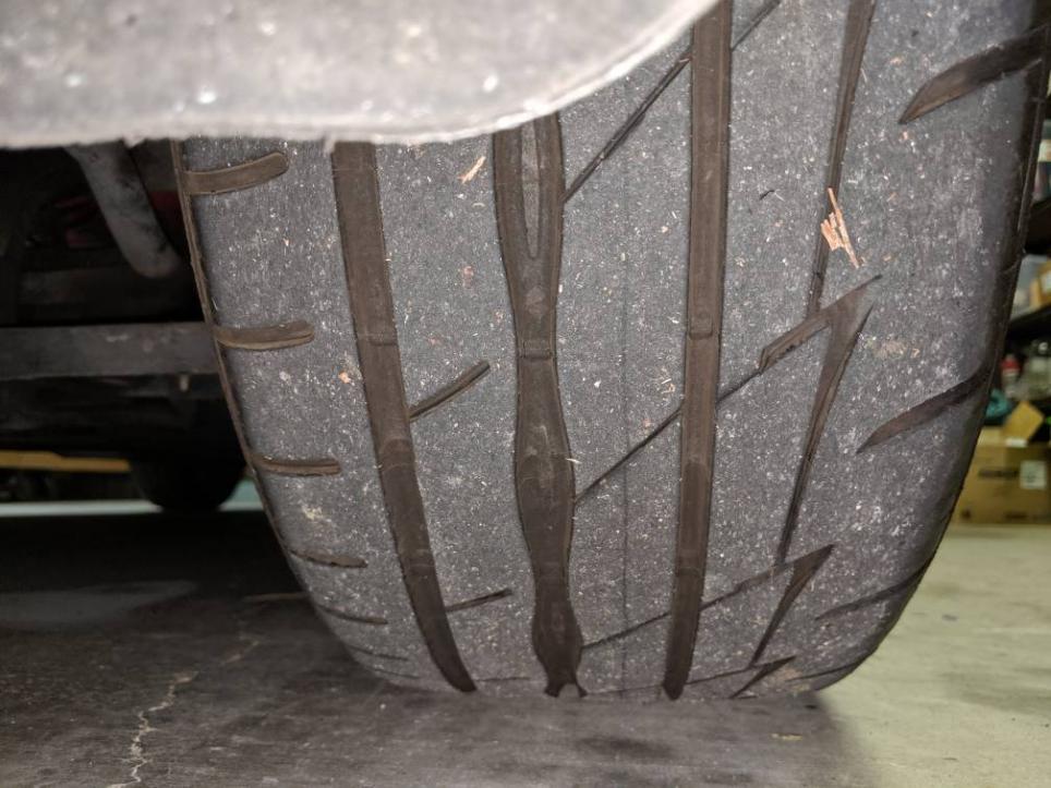

    Tire pressures are 36psi, tires have done approx 14,000kms
    I've attached photos of passenger side front and rear wheel
