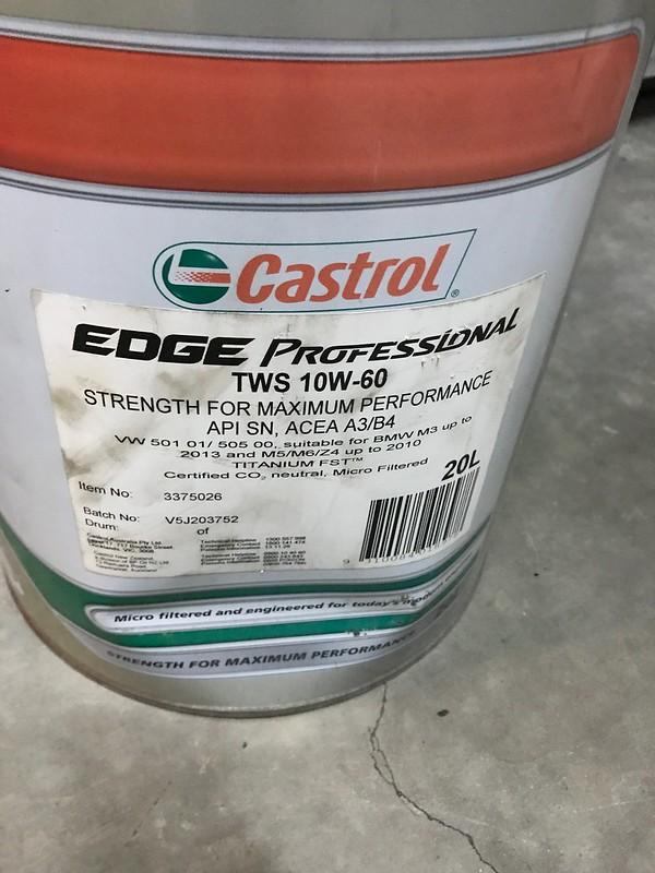

    time for an oil change...
    I went with the recommendation on the sticker...
    picked up the oil that was left from the previous owner so I know he was using the good stuff..
    using the genuine bmw oil filter too...
