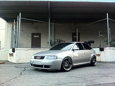

    Been torturing myself this week looking at wheel setups, just can't justify the money at all at the moment.
    Here are my favourite combinations at the moment.
    rota grid 18x9.5
    and Enkei rpf1's same dimentions
    Attached Thumbnails Attached Thumbnails Joe's S3 build up-344czgg-jpg   Joe's S3 build up-rpf1_zpsznkrfjce-jpg
    Joe's S3 build up-rpf-1_zpst483erz2-jpg

    also with the rota 18x9.5, unfortunately i'd say don't do it. cop magnet and nothing but trouble on mine, loved them though...
