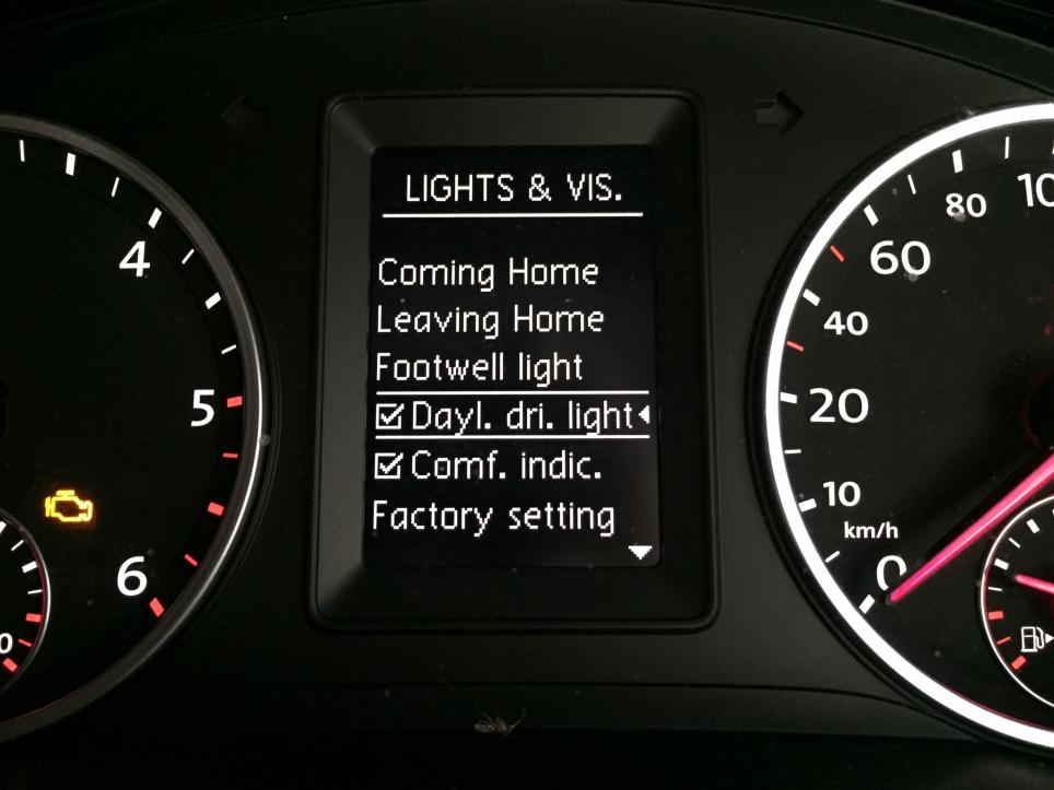

    DRLs and footwell lighting should be able to be changed via MFD. If DRLs do not appear there, you can add the menu item via VCDS so that DRLs can be switched by driver rather than always being off. Cabin Light has a manual switch.

    In that case, you should be able to add it using VCDS.

    As to your desire to turn-off the DRLs via the menu screen, and assuming that my assumption is correct that you have the MQB based Tiggy, then here's how you do it:
    1. Select 09-Cent. Elect.
    2. Select Security Access-16
    3. Enter Code 31347
    4. Click Do it! tab
    5. Select Adaptation-10
    6. Enter ENG116594 into the search box and from the pull-down arrow above the search box select IDE06864-ENG116594-Daytime running lights-Tagfahrlicht Aktivierung durch BAP oder Bedienfolge moeglich
    7. Change the default setting not active to active
    8. Click Doit! tab
    9. Exit RT software
    10. Select Car from the buttons on the side of the media screen. Then press Setup (on the bottom RHS)
    11. Select Light
    12. Enable the "tick" on Daytime Running Light (tick-on DRLs on, tick-off DRLs off

    Don, thank you so much!!
    Followed your instructions and it worked perfectly!! I owe you a martini or two!
