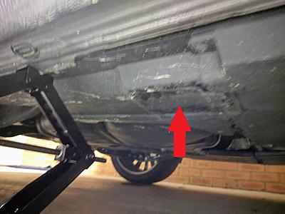

    in my effort to figure how to use axle/jack stands - i discovered additional points, not covered in the manual, or anywhere else on the web.
    since the jack and stand can't fit side by side, i had to find alternate positions.
    happy to b corrected if these are NOT jack points.
    car is an MY17 162TSi Superb Sedan.
    rear one has a rectangular cover...
    Additional Jack Points-jack_08-jpg
    rear one with cover removed.....
    Additional Jack Points-jack_03-jpg
    front one has a circular plastic cap......
    Additional Jack Points-jack_05-jpg
    front one with plastic cap removed.....
    Additional Jack Points-jack_06-jpg

    I wouldn't use those spots. Just stick to the ones on the sills.

    My preferred choice would b car ramps.
    But the ones from Supercheap/repco etc etc do not clear the front bumper.
    The caravan ramps far to low height wise.
    I'm not planning to go buy a pair of caravan ramps, trolley jack and Jack stands.
    I'm buying just a pair of Jack stands.
    All those points r on the sub-frame or chassis.
    There are two identical ones at the rear, and two identical ones at the front.
    I'm no mechanic, so I can't confirm.
    But it sure as hell looks like very plausible jack points.
    I couldnt take a pic of the actual point - it is solid metal.
    Looks more safer than the sill jack points if u ask me.
