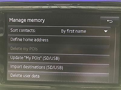

On the Navigation settings screen, tap the Manage memory button.
On the Manage memory screen tap Update “My POIs” (SD/USB).
You will be taken to an Update my POIs screen, with an Update button at the bottom.
Tap the Update button.
