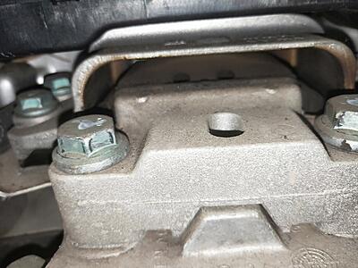

    I replaced engine and trans mounts today. Lately there have been a few thumps from 1st to 2nd at low speed and from park to reverse on a cold start.
    I cannot believe how worn they were. I had to raise the engine about 2cm get the new mounts close enough to bolt down.
    What did you do to your Mk5 today?-trans-gap-jpg
    There should be no gap here !

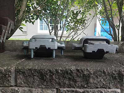

    What did you do to your Mk5 today?-trans-slop-jpg
    Trans old vs new.
    Similar story on the engine mount.

    Time will tell if it fixes the hard shifting.
