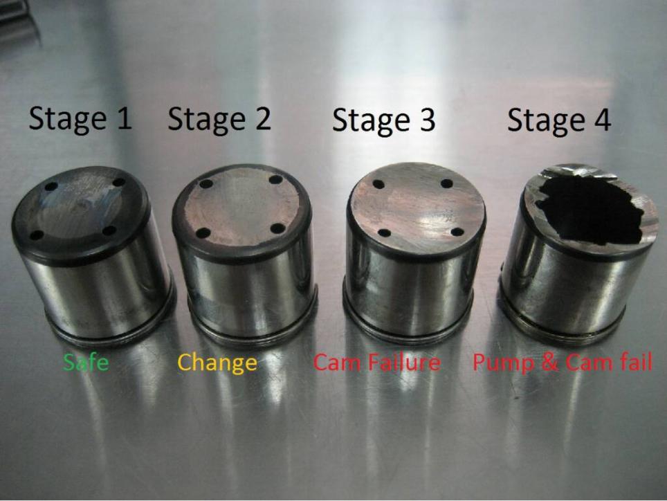

    I had a suspected fuel cut last week and as part of my investigation I checked the cam follower on the HPFP. It is not worn much at all.
    Speaking to my mechanic he says they have not seen a single cam follower failure. This seems at odds with the internets, mostly US posts on the BPY engine. Australia got the BWA engine.
    I'm wondering if the BWA engine is not as prone to the same cam follower issue.
    Thoughts ?
    Pics of the cam follower after 35,000km (original replaced at 60,000k)

    That follower is pretty worn, you replaced it at the prefect time. As soon as the black casing is worn through, the wear is exponential I've been told. Are you tuned? Either way. Great to replace I just did mine about 2 weeks ago and it was similar to yours after 10,000kms (Stage 2++ k04)
    Car is stock
    I thought it looked fine. Did not change it. Figured it looked like stage 1 in pic below.
    I'll pick one up and change it, cheap enough at $30 anyway.

    Quote Originally Posted by JustCruisn View Post
    Car is stock
    I thought it looked fine.Did not change it. Figured it looked like stage 1 in pic below.
    If you have the revised HPFP it should last longer than 50k. Mine was rebuilt and the newer HPFP was put in. Its done 30k already and no wear what so ever and its tuned.

    [QUOTE=sandwg;1186031]If you have the revised HPFP it should last longer than 50k. Mine was rebuilt and the newer HPFP was put in. Its done 30k already and no wear what so ever and its tuned.[/QUOTE
    Just confirming, the revised follower was MY08 onwards?
