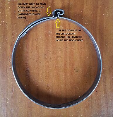

    Thanks for the info re the PCV valve routing Justcruisin. Well I've finally found the time to finish the repair and the hardest part was the crazy clic-R hose clips! I managed to reuse 5 but had to buy 3 new ones at $15 each bartered down from $20 each from VW (I could not find them anywhere else).
    Turns out the clic-R pliers I bought were too thick (see attached pics) as I couldn't get them to close the clips, even though they opened the clips fine. These clips may be great for the robots assembling the car but for us humans they are a giant pain. I tried to find regular hose clamps to fit but all of them were too wide to fit the rubber hoses.
    Anyway, reassembled the intake manifold and smoke tested it again and everything was ok. Runs great now and rough idle gone. Thanks to Justcruisin and MEL744 for your valuable assistance.

    No problem, happy to help out! That's very annoying about the pliers not workings, those clips really are a pain! Would you mind sharing the link to the pliers you bought so we can know which ones to avoid?
