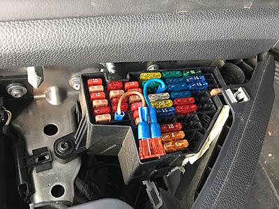

    here we go just a
    2 lengths of wire mine were about 6cm long
    2 female Spade connectors
    2 male spade connectors (You will need to file one down to about half the width to fit in the small fuse holder)
    Make 12v turn off with key?-img_9370-jpg
    Fit a Male to one end of each wire and a Female to the other. and file down one of the males to half thickness to macth the small fuse connector width
    Make 12v turn off with key?-img_9375-jpgMake 12v turn off with key?-img_9374-jpg
    Stick the filled down spade plug in to the top slot of the no 11 fuse holder and the full size spade plug into the bottom slot of No24 fuse holder
    Make 12v turn off with key?-img_9378-jpg
