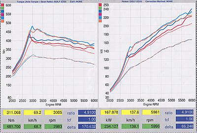

    I have 481nm at the wheels and it has been fine for 30,ooo km. After that sort of power increase clutches become the next issue. DSG software can also help.

    oh and no one has 481 NM from a stage 2 tune bahhaaaaaa
    Yes haha... this seems funny but Dyno result say otherwise. GTI35 standard with KO4, so yes it is closer to a stage 3 than a stage 2.

    80
    See attached.
