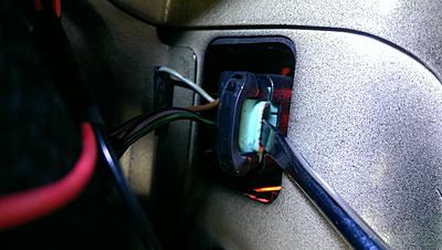

    1. First begin by removing the rear harness for the rear lights, I found using a flat head screwdriver would do this with ease.
