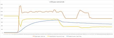

    Here is a couple of graphs Ive made from the VCDS logs which show the issue nicely the dodgey section is the first 30 secs the second rise in the idle speed at around 40 seconds is me intentionally raising the RPM to around 1200 to see what effect that has on timing etc.
    The low manifold vacuum and extreme timing retardation is what stands out to me but the question is why?

    the thing that beats me is why the ecu is pulling the timing back to 25deg ATDC.
    I did think the manifold vacuum could have been a dodgey MAP sensor but Ive hooked up a vacuum guage and get the same readings. I need to have a lok at the cold start ecu map and see why its calling for such retarded timing.
