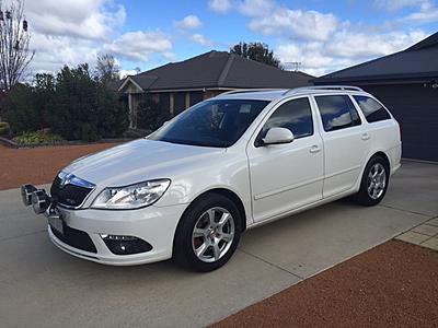

    Well, ended up with the 7.5x16 ET45 Audi ones that Brad pointed out + 225 50 Bridgestone RE003s.
    Did not get around to weighing the rims but the are significantly lighter than the 6.5x16 skoda ones that came off...
    Lets see how it goes. Feels good at the moment (don't mind the road grime....).
