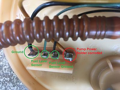

    Car struggled to start in the morning (same as every other time, had <1/4 tank of fuel). Finally got it going, drove 1hr to work and could hear a slight humming noise coming from the rear seat.
    Went to start her up at smoko and she wouldn't go. Fuel pump dead.
    Got home, pulled the pump out of Project Bora R32, stuck it in and all is well again. Poor photo but upon further inspection of the pump, I suspect the soldering on the positive wire is shot which would explain why the problem was intermittent due bad contact at this solder joint.
    Random Stalling, hard to start and EPC light-img_0804-jpg
    Also, on a side noted. Pulled the R32 pump out of the Golf and stuck it in Bora R32. Different part no.'s but identical in size so not sure what the difference is.
