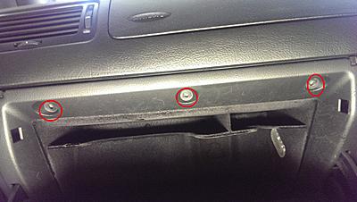

Then remove the 6 screws in the glovebox.
![Howto: replace V71 recirc valve motor-2013-12-28-12-49-49-jpg](https://www.vwwatercooled.com.au/forums/attachments/f14/7050d1388560753t-howto-replace-v71-recirc-valve-motor-2013-12-28-12-49-49-jpg)
![Howto: replace V71 recirc valve motor-2013-12-28-12-50-04-jpg](https://www.vwwatercooled.com.au/forums/attachments/f14/7051d1388560766t-howto-replace-v71-recirc-valve-motor-2013-12-28-12-50-04-jpg)
