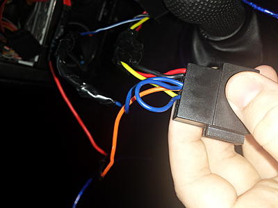

    So im pretty sure this looped over wire is why the aftermarket headunit interferes with the diagnostic ports data flow .
    So it i was to cut it off would my head unit still function fine and give me full access to the data port ?
    Its kinda annoying knowing every time i need to scan my car the head unit has to come out ....

    All the info you need is in the thread I sent you mate. As it happens to be I'm a local on the GC and Brisbane, I like Corona's buddy .
    Yeah speak to the boys @ Eurotune in Miami next time, they would have been able to tell you about the radio issue instead of trying to charge your hourly to 'fix'. Very knowledgeable workshop.

    Oh didnt even see the link , my bad ... sonif i chop it all will be fine ?
