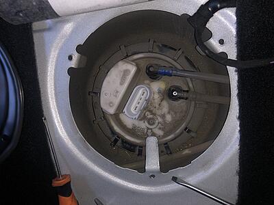

    I had some free time to get another part installed and this time it was a fuel pump. I'm not shooting for crazy power so I decided to stick with an OEM unit so I got a brand new Pierburg unit for a fairly decent price.
    Emad's MK4 GTI-img-4879-jpgEmad's MK4 GTI-img-4883-jpg
    I don't think there was any issues with the fuel pump that was in the car but I thought might as well replace it before the car gets tuned

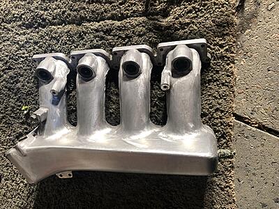

    Some more updates. I've drained the coolant system and started installing the coolant flanges, thermostat + housing etc;. I've also taken off the intake manifold which will be sanded and then polished. Thanks to my younger brother who is putting in the work whilst I'm at work

    The intake manifold is still a work in progress. I honestly see why people just paint it, what an absolute ****e job. I'm going to temporarily run the manifold as is and continue getting it polished later as I need the car out the garage.
