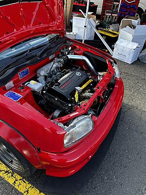

Haven't updated the thread in a while so thought I'd make a post. Haven't done much other than buy more parts but not install them as I normally do. It's no longer a daily car so it spends most of its time on jack stands waiting for things to be installed or in the driveway
