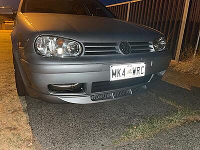

    This is how it looks with the bumper on. Unfortunately I can't run the lower grille but it also looks cool. The lip doesn't fit so well too but once the new lip is on it shouldn't be an issue. In terms of the what to do with the lower grille, some people have used mesh but it won't match the design/look of the upper grille (especially once I go badge-less). I'm sure I can make something work otherwise I'll just keep it hotboi spec
