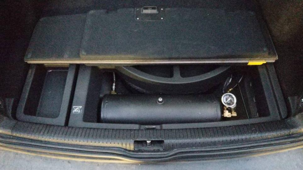

    So stage 1 of the air install is underway
    Twin 444 compressors
    3gal tank
    3/8 lines
    Elevel valve block
    All hidden under the floor with spare wheel and space for tools.
    Ghetto'd up a gauge holder until the sensors go in
    First set of wheels have been pulled out of storage. Here's a hint

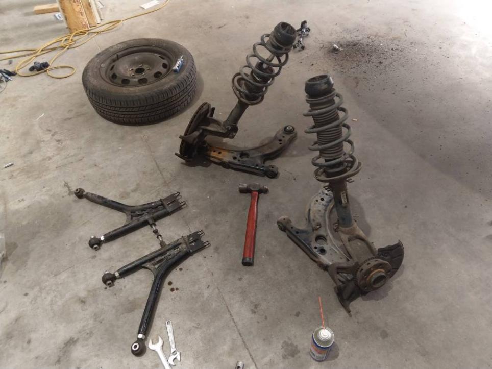

    Started the scary process of pulling out the stock suspension. One side came out easy. The other side gave me some grief with bolts snapping and damaged nuts from the UK corrosion.
    This pushed me to swap everything rather than just struts.
    Idf arms in
    Tt spindles in
    Tie rod flip and mirror done (one was so rusted it needs replacing)
    312mm brakes going on the front until my 334mm r32 caliper comes back from repairs.
    Even the abs/speed sensors were rusted in place so these will be getting pulled from my old bora tomorrow along with a few other nuts and bolts
    Rear beam from the bora going in along with idf drop plates. 232 to 256 vented upgrade it the same time
    Hel performance brake lines all round
    Seem to have misplaced my eibach sway bars so the hunt for them is on so I can throw them in at the same time

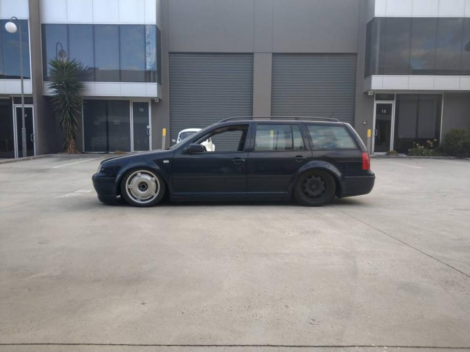

    So last minute change up.
    Didn't have anyone free to help lift the beam in, so stock brakes and beam for now. I'll throw it in when I do the 32 fronts and give the brake system a full flush.
    Fronts 312mm for now. Stock sway bar also retained.
    Still need to get the abs/speed sensors out of the bora and out the interior back together. So far no leaks but will leave aired up over night for the first test.
    Lots of work to get the front down where I want it
    Sent from my HTC 2PZC100 using Tapatalk

  6. #56
    7,501
    Few snaps of what I was dealing with

    Have some slow leaks.
    Haven't been able to identify them at any joins or fittings yet. Hoping a service on the valve block (7~ years old) sorts these.
    Some more pics. Needs more lows and then matching wheels
