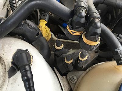

    Started disconnecting all the coolant lines.
    Bora R32 Build Thread-img_8035-jpg
    thermo housing
    Bora R32 Build Thread-img_8261-jpg
    Bora R32 Build Thread-img_7982-jpg
    return lines at the rear of engine, on both sides.
    Bora R32 Build Thread-img_78721-jpg
    And this little bugger for the secondary coolant pump.

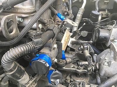

    cable ends for the gear selectors and speedo sensor.
    Bora R32 Build Thread-img_7980-jpg
    Bora R32 Build Thread-img_7981-jpg

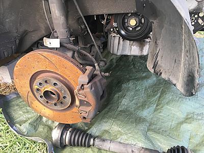

    driveshafts out
    Bora R32 Build Thread-img_7871-jpg

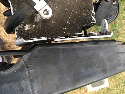

    And lastly. Decided to put the bar rio up to take a better look at the impact on the rails.
    Bora R32 Build Thread-img_8263-jpg
    RH rail is out but it's nothing major, just looks bad from this angle because the mounting plate is all bent up. But the LH could be out a little as well although I couldn't see damage to it, the bar rio should sit flush.. And because of the angle of impact it is possible it's pushed both rails across a couple of mils.
    Bora R32 Build Thread-img_8262-jpg
