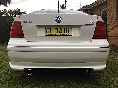

    Busy weekend on the 4mo. After spending 8mths tripping over the body kit in my shed I thought it was time to fit it up. I couldn't fit it up earlier as the lower skirt at the rear doesn't clear the tail pipes. The meant I had to do the body kit and exhaust at the same time.
    Stock:
    Bora R32 Build Thread-img_7484-jpg
    So once the bar cover was off it was time to split it. I left it out in the sun for an hour or so to soften up then got to it. So to split the rear bar it's basically all clips in
    Bora R32 Build Thread-img_7485-jpg
    Then once it's split, with the Oettinger rear skirt.
    Bora R32 Build Thread-img_7486-jpg
    And a few final pics once it was fitted along with the BBE exhaust.
    Bora R32 Build Thread-img_7489-jpg
    Bora R32 Build Thread-img_7487-jpg
    Bora R32 Build Thread-img_7488-jpg
    Unfortunately I had misplaced my phone earlier in the day (later found it in the engine bay of the R32 wedged behind the expansion tank , must have slipped of the skirt and fallen) so I didn't get many photo's of the skirts or front splitter getting fitted OR the exhaust. The front splitter clips in the same as the rear skirt but from my previous experience if you scrap it then it can come unclipped so I used a few small dobs of Sikaflex, 1 at each end and 2 in the centre only about the size of the 5cent coin.
    The side skirts, 3M double sided tap again 2 dobs of Sikaflex at each end of the skirt, then they get screwed in at the ends.
    The exhaust sounds phenomenal! Nice burble under about 2500rpm but sounds nice and throaty at anything above 3000rpm.
