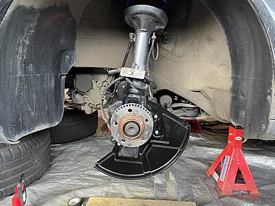

    Onto day 4 of this madness, unfortunately due to the cold weather the paint was not touch dry until the next day.
    removed all the masking tape, regreased all the slide pins.
    Bora R32 Build Thread-img_6486-jpg
    Then it was install time.
    Bora R32 Build Thread-img_6489-jpg
    New dust shields, new bolts, screws, rotors, pads, fluids.
    Bora R32 Build Thread-img_6497-jpg

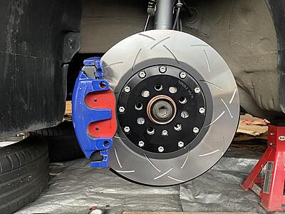

    Before
    Bora R32 Build Thread-img_6413-jpg

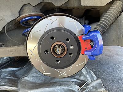

    After
    Bora R32 Build Thread-img_6500-jpg
    Rears before
    Bora R32 Build Thread-img_6425-jpg
    After
    Bora R32 Build Thread-img_6495-jpg

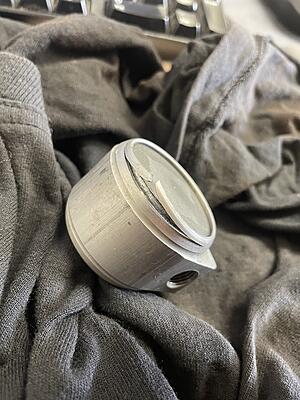

    Back in December I was cruising home from work and the pedal just sunk to the floor. Popped the bonnet to find hydraulic fluid all down the back of the firewall. Turns out the clutch line "dampener" had split open.
    VW don't sell the dampener separate to the line and a new line was about $400 and the best bit... It was 8-12week back ordered from Germany.
    So after speaking with a friend of mine he suggested the following.

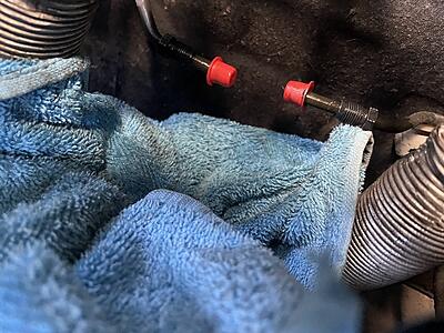

    Male/Female Hydraulic adapter M10x1 Drill point, then attaching a Female/Female Adapter, again M10x1. Using the 2 adapters gives you roughly the equal length of the dampener.
    Been running this now for approx 3mths, maybe 15,000kms. Zero issues and clutch feel is exactly the same - just more over engineering from ze-Germans.
    Here's the dampener.
    Bora R32 Build Thread-dampener1-jpg
    RIP.
    Bora R32 Build Thread-dampener3-jpg
    Replacement Parts
    Bora R32 Build Thread-dampener51-jpg
    Bora R32 Build Thread-dampener4-jpg
    Old one out and new one in.
    Bora R32 Build Thread-dampener81-jpg
    Bora R32 Build Thread-dampern9-jpg
