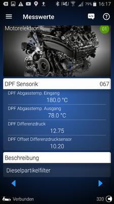

    today I´ve looked at DPF related values. The DPF warning light was on each 250 km. I dismounted the DPF, cleaned it with a Kärcher and now I took a view to the DPF-values and would make a reset of the soot charging values. But the values are strange:

    MSG_MW67:
    Value 1: DPF-load/%: 21 - 21% of what? sood? ash? Both? How fit this 21% to 0g mass of ash of MSG_A12?
    Value 2: ash mass/g: 0 - How ist this value determined? calculated? How fit the 0g ash mass to the value 1 with 21% load?
    Value 3: Ash mass learning value/g or % - g and % do not fit together. What is the meaning of this value?
    Then I made two meassurements of the DPF-differential pressure value:
    MSG_MW_67 at idle: Diff-pressure 2,55 (Unit?), offset 10,2 (Unit mbar?)
    MSG_MW_67 at 2000rpm in neutral position: Diff-pressure 12,75 mbar - ist this a reasonable value?

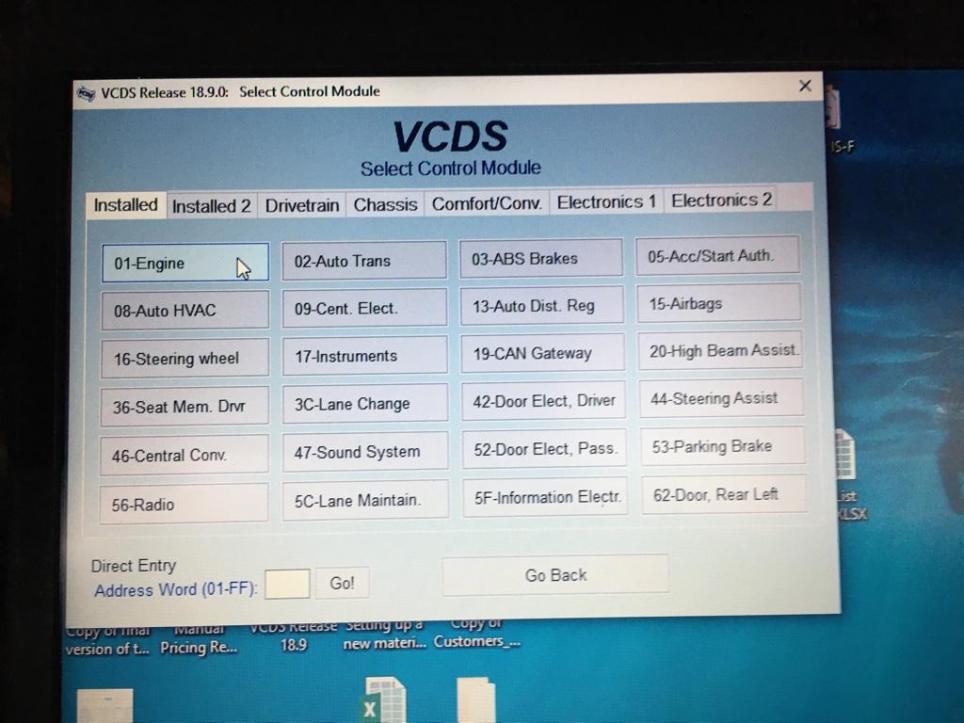

    6,070
    VW T5.1 DPF related Values obscure
    Ok here we go. As mentioned, you will need the VCDS (Ross Tech) cable and software and a Windows based laptop.
    Select: 01-Engine
    Select: Basic Settings-04
    Select:
