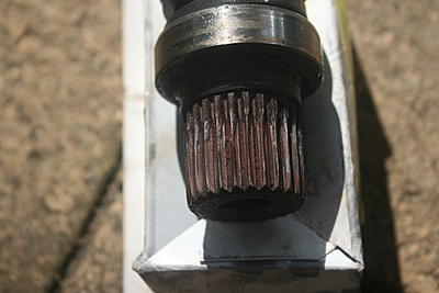

    Well that's a first for me an auto with a dual mass flywheel , I thought all manuals had the DMF and the DSG was a semi automatic with no need for the DMF . I just googled that and yes the clutches are bolted to a DMF , seems VW want owners to suffer even more these days with another expensive hit to the hip pocket when their smart ideas go belly up . Out of interest have you had the drive shafts checked ? My manual T5 had rattles so to speak in shift changes and the splines were the problem , apparently the toffee composition of the splines wont last long . Might be an idea to get a second opinion .Normally when the DMF is dodgy it is very hard to reverse up a hill , my DMF has been buggerd for over 10 years nearly . I only learnt about the mongrel DMF AFTER I changed the clutch plate etc so I was not prepared to pull the bloody gear box out a second time so I kept driving and driving and driving . So now with over 300000 km on the clock its still in there shuddering in reverse but some clever slipping of the clutch will get me out of any situation I may be silly enough to drive into
    Hey sunny43.5, are the shafts on the dsg box troublesome aswell? Or just the manual box.

    The splines wear away, as it's bare metal on bare metal.
    When replacing the stub shafts, you're meant to apply some grease to the splines.

    If it were quick and easy, yeah I guess so.
    But it's not. Whole driveshaft need to come out though.
    Yeah I seen that the last time I had mine on the hoist but if it saves a stub breaking it might be worth it.

    If I have the shaft out for whatever reason, I generally throw a bit of grease on the splines and leave it at that.
    If you were pulling the shaft out specifically to grease it, you'd only need to do it once.
