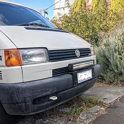

    Hello!
    I made up a bracket to fit a STEDI lightbar to my VW T4. The number plate screws onto the front of the bracket. Here is a photo and engineering drawing for the bracket and required spacers. The bracket is quite light and certainly stiff enough using 3mm aluminium sheet. Spacers are aluminium too.
    Installing a light bar or driving lights-img_20200315_103728-jpg
    Installing a light bar or driving lights-lightbar-bracket-png
