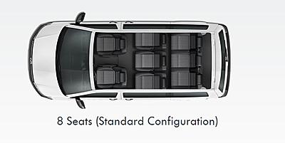

    I am considering ordering a LWB T6 Transporter 4motion/DSG and sourcing from OS a 2nd row 3 seat option available in overseas T6 Shuttle models, as shown in the photo below. Obviously for a local install I'd need an engineers report and source the mounting rails which are the same as found in local Caravelles/Multivans. Apart from cost what issues could I come across or could stop me from doing this as I've only ever fitted a local manufcatured 2nd row seat before and it was dealer organsied.
    The UK VW website spec sheets lists it as "3 individual seats with easy-entry feature on outer seats, all backrests individually fold, in 2nd row." What really annoys me is it's only a £1,056 option on new Transporter vans.
    Fitting overseas sourced genuine VW seats in a local T6-shuttle-jpg

    The rails would be the first stumbling block as the original ones would be bolted to prefitted captured nuts on the underside of the floor which would not be fitted to a base model van , these nuts are positioned on chassis rails or at least reinforced areas of the floor . The aftermarket ones you had in your other van would have had specific sized plates fitted under the floor and the seats themselves would have been tested with those plates same for any seat belts mounted to the body . Now an overseas seat will probably be ok but any seat belts would need to be cross referenced to Australian ADR numbers before use . I know from doing van seating and belt modifications for over 25 years it can be a minefield to get the safety aspect correct . We used to get customers bring an import vehicle to us for certification and we would check the numbers against the same brand of car ie Toyota or whoever , if the numbers on the belts matched then it was okay but if not brand new Australian Standard ones would have to be fitted .

    It does not look like the seats in the picture are on Multivan rails: In the Multivan, 2nd and 3rd row seats are lined up exactly. Whereas, in the pic, 2nd row seats are offset to be closer to doors. This means they are installed into fixed bracket slots (AU Caravelle style), not into Multivan rails.
    Overall, would you not be better off with a regular Multivan, replacing 2nd rows chairs with one more standard 3 seat bench (facing backwards for better access to 3rd row). This will give you 8 seats while keeping all the Multivan benefits like back row air vents and shade curtains?

    Yes correct Tiguan but the seat could be offset on the rails as that is a common practice with lots of people movers . But either way still a pain to modify a non seat van .
