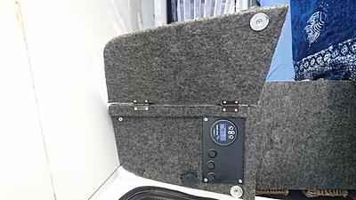

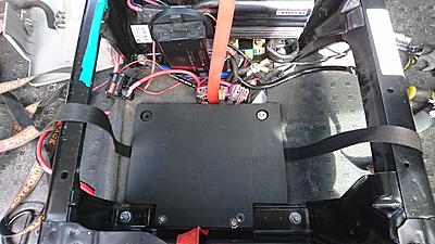

    I have mounted a 135AH AGM battery under the drivers seat on its side, which is safe to do with AGM batteries. Rearranged some of the wiring that was there.
    I'd recommend a DC/DC charger too. I kept a Redarc BCDC1225 from a previous vehicle though if I had to get another one I would go with the Projecta IDC25.
    There is an anecdotal measurement of AGM battery value which is to calculate the "cost per kilogram" and couple this with the warranty which the manufacturer offers. Based on this the PowerAGM brand from eBay seller autoelecau is good value. 6 months in and no issues to report.
    Size? You'll never complain about having too much stored power! There's a sweet spot in terms of value around 120AH.
    I ran a 6 B&S cable from the main positive, through the rubber grommet located behind the battery tray into the passenger footwell. Make sure there is a downward loop on the outside to stop water running down the cable. From there, there is a cable channel across to the drivers seat (you could just go to the passengers seat).
    Fuse both ends and mount the DC/DC as close to the auxiliary battery as possible, mine can be seen on the side of the seat base in the photos below. The other thing in the photos is a shunt for my battery monitor which you won't need. Earth to the chassis through the seat bolt.
    I've done a few, can give you whatever info you need if you're keen to DIY.
