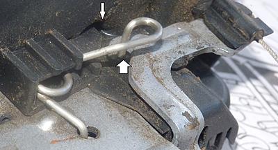

    Before I commit myself further now the lock is out of the vehicle, I would appreciate some guidance.
    Once I give it the kiss of life, I hope that I should be able to activate the lock before refitting it by plugging it into the door loom. Is that correct?
    When I removed the lock I found that one spring seemed to be out of position. It was butted against the black casing shown by the smaller arrow, not in the lever notch where I repositioned it.
    Door lock deadlock release T5 2005-p1040389-jpg
    It may have bounced out when I disconnected the external handle, but with it positioned where it is, there is significantly extra effort needed to pull the outer handle cord.
    Did I do right or wrong repositioning it?
    Any chance it had anything to do with the locking issue (clutching at straws)?

    No incorrect it should be same as this one in our van .I have a load of other photos showing dismemberment if you need them ?Door lock deadlock release T5 2005-20161212_171610[1]-jpg

    Thanks. Wonder what the slot is/was for?

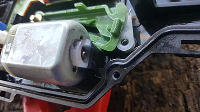

    Ah ha if no text no photo , sorry there not in order , one important thing when reassembling the electric motor part ensure the parts are engaged correctly . The first time I did it the lock would not work properly so I had to redo it a second time and then it was perfect . There is a locating guide that goes into the green part as it locks and unlocks it move from one slot to the other .

    I've cracked the lock apart & tried test assembling it before I start messing with it, but I have 2 issues:
    (1) I can't understand the function of that green plate under the worm drive. When I dropped the case apart, it was operating in the left track, but I see that it has a spring that can toss it into the right arm of the Y. Do you understand what function it performs.
    (2) I can't slip the two halves back together. The shroud around the pin that sits in the top of the worm & drives the door open indicator doesn't want to slip around the base of worm opening. Did you have that issue & what answer did you come up with.

    OK, I give up. I got all the electric bits & their case in a ready-to-go-if-they-ever-will status & had a last fiddle to prove the mechanical side of the lock - and suddenly the bloody thing won't unlatch when the yellow disconnector is raised and either of the door pull levers is activated. That's not quite true, it does it one time in 10 & that's not enough for me to trust the damn thing when I reassemble everything.
    A second hand lock with a 6 months warranty is on the way. I should have done that a week ago.
