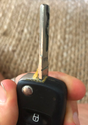

    Anyone had any experiences with the blade being broken and can't switch the blade over to a new fob? Wondering what my options are for getting a new key - right now super glue is holding it together.

    Broken key issue-screen-shot-2021-01-01-1-29-26-pm-png
    So the blade within has broken off from the flipping mechanism.

    Look on AliExpress use the number on the side of the key.
    There are some stores that you can send a photo of the key and they will send you a cut key and new fob case. Swap the key and cct board over ( which has the ID chip) and you have new key.
    Click in description to get CNC cutting of key.( they will send you cut key)
    YouTube on how to swap over, have to push the locking pin in on the old key. NB. Don’t push the pin in too far only enough to separate. Make sure to put the pin back or they key may pop open if you drop it.
    Or you can go to a locksmith and get new key $300 or VW for about the same.
