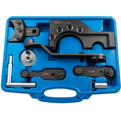

    So to summarize, the special tools I've needed so far:
    2.5 TDI timing / lock set, my $185 China set has been just fine.

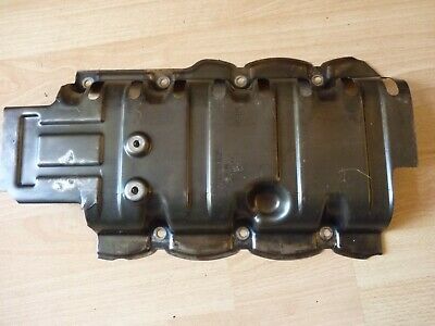

    Then I noticed the windage plate had a chunk roughly cut out of it below cylinder 5!
    2.5 TDI Transporter BPC 2009 info thread-imag0575-jpg
    At first I thought the engine had dropped a rod or something major, but there were absolutely no marks around cylinder 5 at all. The only mark I could find was some rub marks on the arm of the oil pump. I thought this was weird, so did some research. Was hard to find much, but I eventually put it all together. There were also no pieces of it anywhere, so it's been purposely removed!
    Here is how the plate should look.
    2.5 TDI Transporter BPC 2009 info thread-vw-touareg-transporter-t5-7l-25tdi-axd-axe-jpg
    Mine is missing the end flap that is unsupported. Seems that this end flaps up and down, develops cracks, and then breaks loose and causes all manner of problems. The T4 crew know all about it.
    So tonight I went looking for a new one, and found this on eBay uk. Already on the way out!!
    2.5 TDI Transporter BPC 2009 info thread-windage1-jpg
    2.5 TDI Transporter BPC 2009 info thread-windage2-jpg
    So I'm glad I dropped the sump, and will replace the baffle plate EDIT I bought a new one and welded some major metal reinforcement on these corners and braced it around the bolts that hold it on, should be far, far stronger now.

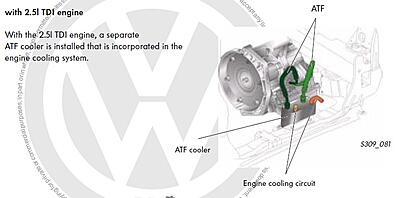

    I've finished my large transmission cooler, but at this stage I've had to take the 12V fan it came with off to get it to fit. I'll make a better job of placing it so the fan can be fitted as well, just to be sure, but for now this will do fine. For anyone else wondering, working out the inlet and outlet lines for the 09G auto box is difficult, and there's stuff all online, took me a fair bit of web browsing to find anything at all. I believe the outlet from the auto box is the line closest the bell housing ( drivers side ) and it has a vertical gearbox bracket. It is also the outer bracket on the single bolt that holds both lines into the box. The return line is further towards the passenger side, and has the inner, horizontal to the ground support bracket. Only matters if you are running a thermostat valve like I am ( probably a waste of time in Australia ) but figured I'd do it right whilst in there. It did make filling the box a piece of cake as I just used a funnel on the cooler by taking the temperature switch out, and the whole 5.125L that came out went back in fine, albeit slowly. Will get it up to temp and do the levels tomorrow.EDIT- my later purchased auto manual shows this inlet/outlet as correct!
    Here's the only pics of the lines I could find from a vague self study document on the box, and I assume the dark green outlet shown on the first "golf/passat" box corresponds with the dark green on the 2.5L box I have. I will put a temp gauge in the line, so will quickly work out if this is correct or not!
    2.5 TDI Transporter BPC 2009 info thread-box1-jpg
    2.5 TDI Transporter BPC 2009 info thread-box-2-jpg
    Also be aware that the fans will run flat out with the front bumper off, as the wiring for the temp probe ( and passenger headlight ) runs through the bumper. Took me by surprise till I had a look.
