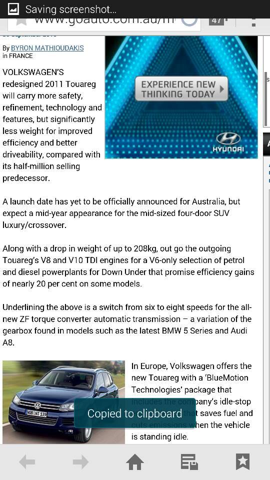

    According to this review, the 2011-on model does use a ZF, the same 8spd as in the rok . . .

    Well, VW seem to think it has an Aisin auto in it. VW SSP466 (Self Study Program) is for the gearbox (there is an English language version on a south African website) and it says Aisin. SSP469 has the transfer case without center-diff lock and SSP302 has the transfer case with centre-diff lock.
