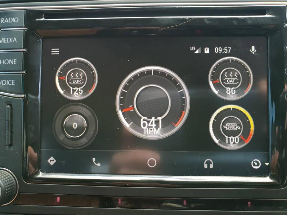

    Does anyone know what android app and OBD module works with the Amaroks so I can bring the details up on Android auto like Jeromeos photo of the app that he was using?
    This is the info he provided
    Quote Originally Posted by jeromeo View Post
    The last screen shot is using torque and custom Pids.
    But VAG DPF definitely works, you have to use engine 10.

    You need a little program called OBD2AA to use with Android auto.
    But its not really straightforward to use.
    Little bit buggy doesn't always start at first go.
    Sent from my SM-G965F using Tapatalk
