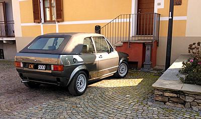

    Just picked up the Cabby from the body shop for some little touch-ups...
    Getting ready for those 15" rims...
