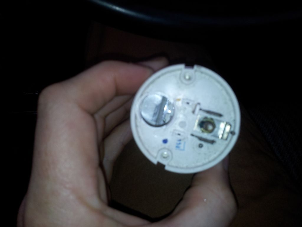

    Oil Gauge cable link see pictures. Anyone got one or a spare they want to sell???
    [IMG][/IMG][IMG][/IMG][IMG][/IMG][IMG][IMG]
    PM or call 0420694517

    FYI that's a pressure gauge not temperature.
    You need a pressure sender which matches the scale of the gauge and that usually goes in the side of the head or above the oil filter.

    Sorry took photo of wrong section was hung over. so can i get a pressure sender easily?

    There's also a pressure switch in there, so you need to put the sender in the right place to replace the switch and give you the pressure output to the gauge.
    Pick one that matches your gauge, if the gauge reads to 100PSI you need a 100PSI sender
