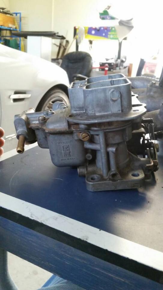

Fuel lines should have arrows indicating feed and return.
