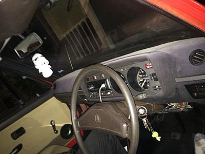

    long awaited update (i guess)
    refinished the dash because last time i did we did it a very bad way and royally screwed up.. nothing as pretty as others but it does the job. just needs a coast of fabric dye to look good again.
    build thread :)-img_0571[1]-jpg

    once i get more seats for the rails i'll have a better interior pic. Also Would anyone know where to get a steering boss that will fit a mk1 for a momo wheel?

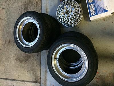

    build thread :)-img_0617[1]-jpg
    stay tuned!
    also, build thread :)-img_0621[1]-jpg
    how would one go about fixing this, quite deep and on all 4 lips..
    i wouldnt mind the best route to go with sanding the lips... quite alot of pits and all that.

    Quote Originally Posted by Pilks View Post
    stay tuned!
    Are these Simmons? If so, do they clear the front brake carriers?
    Best way to get rid of gutter rash and pitting is to mount them up on the car (no tyres or valve stems) and hold some course sandpaper or even a file up to the outer lip. Once it's all level, continue with finer and finer grits as usual
