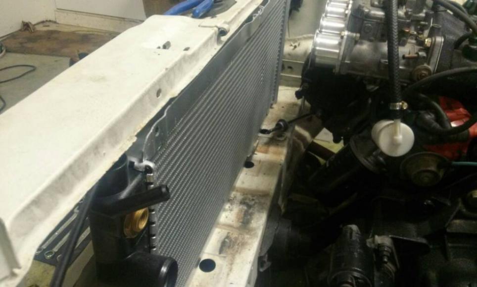

    Any guesses as to what's going through here...
    Big weekend ahead I think. Stay tuned

    Let me guess, hot water plumbing for the rear mounted washing machine?
    Sorry, couldn't resist.
    Radiator looks like it was made for the MK1.
    If only that was true. Much more interesting than what it's actually for. Got to keep those wires weather tight though

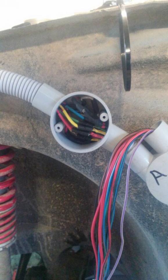

    So here's the recap from the weekend's work. Finished off the wiring loom gents, so here are some photos, even though it couldn't be a more boring topic...
    Colour coded connections for further simplicity
