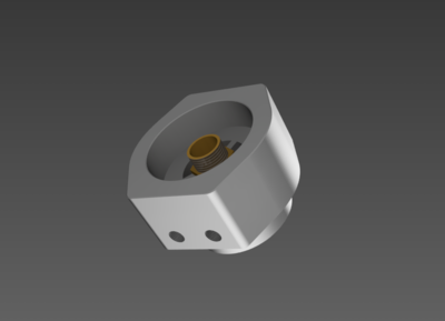

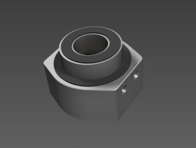

First thing I've been designing is an oil filter adapter adapter. The main reason is I'd like to run an oil cooler, as well as a temperature and pressure gauge. There are plenty of sandwich plates around, but none of them are compatible with the 1.2tsi because our filters have a springed plastic piece on the bottom of the filter.
