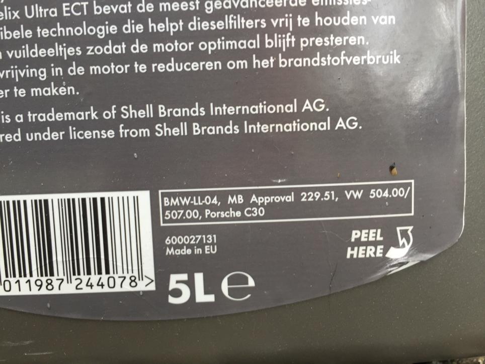

    Shell has the Helix HX8 ECT 5W-30 (in a blue bottle) which is NOT VW 504.00/507.00 approved. The one which is approved is the Helix Ultra (in a silver bottle). I do have a feeling that Shell is replacing the 5W-30 Ultra ECT with their new 0W-30 Ultra C2/C3 (VW 504.00/507.00 approved) as its getting difficult to find any stock of the 5W-30.
    Here's the exact bottle I used in the video (purchased from Supercheap about one month ago):
