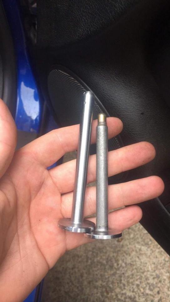

    Rod on the right is OEM, rod on the left is the one I made to suit the commodore master cylinder.
    The rod can easily be made, but like a lot of things, if it already exists it’s often easier to purchase it.

    Ok. I was half expecting the OEM rods to be made from a steel/plastic assembly with rods/springs and sockets knowing VAG. If thats all they are then I can do that on the lathe at work no probs. Being the parts guru that you are, you dont happen to have a 23.81mm MC off a Bora V5 do you?
