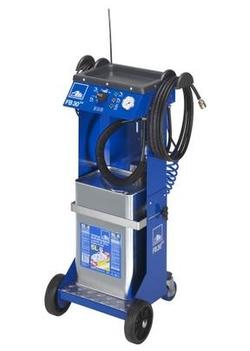

    To change the brake fluid or bleed the air from the VAG brake system, you need equipment similar to this one.
    Ross-tech Bleeding Issue 9N3-detailtemp500d42d8073f5-n1c4cgej-250000-jpg
    The cheap pressurised garden sprayer style ones, that people buy for cheap, just introduce moisture in the brake system and microscopic bubbles, don't use them. You wouldn't maintain the same level of safety that your Polo (any car) was built with.
