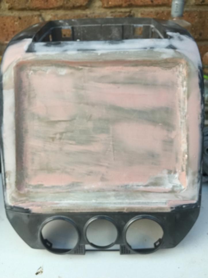

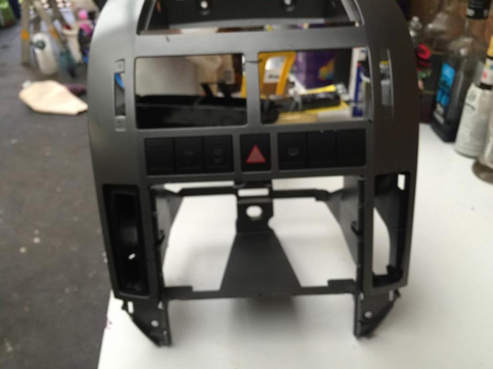

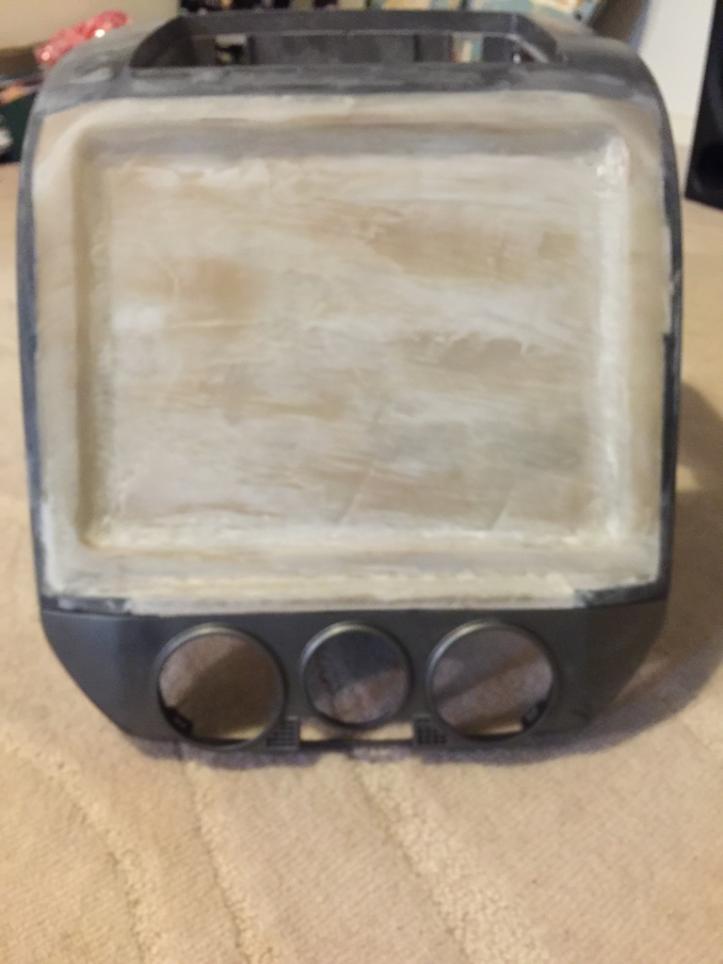

    Just wanted to share my progress with my dash install.. I Was considering a new head unit until I remembered I have an old iPad sitting around that doesn't get used. I moulded the iPad with fibreglass and moulded into the dash.. I will block the air vents that I lost and I'm moulding the switches for hazards ect. Into the panel below the heater controls.. I'm buying a Bluetooth amp that the iPad will pair with and the iPad will use my phones hotspot as a connection for Storify and pandora.. I also have a Bluetooth obd2 dongle so I should be able to use apps like torque to display gauges with temps and track launch times and all that other stuff.. In my opinion it's way better than any head unit I could of bought. I know some will disagree but hey, it's my car in the end...
    I'll try upload some pics now..

    Quick test fit

    Bottom step out to heater controls done and started with a light weight primer

    This is where I'm at now, got some more smoothing to do and I want to sharpen the edges up on the bit around the iPad.
    Then I'll prime it and spray it in 2k gloss black.
    Sorry about the crappy quality of the pics, I bought a new iPhone 6 and the camera has never focused properly :/
