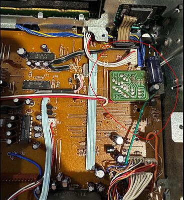

    Your Eurovox 4680, right?
    Those old units don't even have EEPROM, just a combination of diodes.
    Check out this video Eurovox radio cassette CD code removal. Holden Commodore and others. - YouTube
    This is what my eurovox 8790 insides look like, you just need to remove the board and the pin goes back to 1111 Find radio code-radio-jpg
