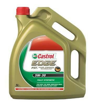

This is the bottle you need. The only one from Castrol Edge that has a different shape
Sent from my HTC_PN071 using Tapatalk
Agree but they make it confusing because the EDGE FST 5w 30 A3/B4 502/505 which could be mistaken for the correct thing is not as is only for petrol engines or diesels WITHOUT a DPF
The safest way to check is by looking at the label on the back which should say APPROVED for VW 504/507. If it hasnt got that dont use it in a TDI
