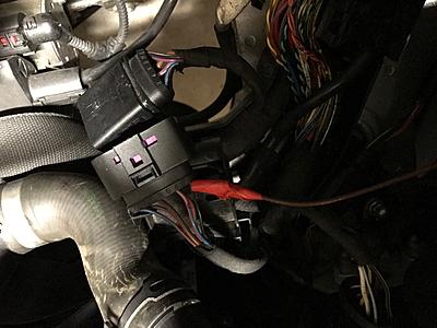

    Ok So after lifting the fuse box under the bonnet. There is smaller black box with pink bits that slides out. Underneath it are cables. One blue cable has blistered and showing wire. So fuse melted this. Not sure what this component is??? I believe it plugs directly in ecu.
    Nov 2016
    Perth
    17
    Jesus this thing goes in ECU, in the dashboard and towards headlights and beyond. I decided to open the cluster of cables to see where exactly this wire goes and to see if i can replace just the wire. The blue wire seems to be blistered and showing threads most of its length so far some 30cm that i have freed. I have a gut feeling it goes towards the engine given the code that popped up. But then again these things are temperamental! Any advice is greatly appreciated. Cheers.

    Show a picture of the wire, which fuse it goes into etc and details on the car, then should be able to give you an idea where it goes. Most likely this will be your problem however.

    Nov 2016
    Perth
    17
    Hi mate,
    First of all big thank you for trying to help.
    2010 VW Golf TSI 118 comfortline/twin charged
    Please see pictures below.
    My finger is pointing to the fuse location which is the supercharger clutch one. The one with a missing fuse.
    Wire runs the entire length from fuse box to the jack below the headlight and i have improvised with a wire which has red insulation tape. I tested it after improvising but still getting the same code. Getting a multimeter today to test connections relating to this wire.

    Need the number next to the fuse mate
