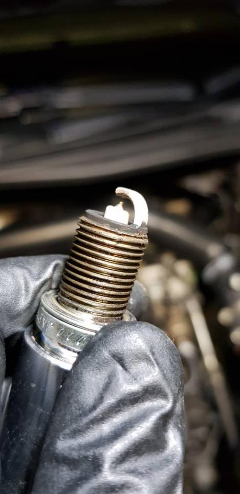

    I pulled the spark plugs out today
    Vw seems to reccomend gaps of 0.8mm and the local guy that does APR tunes said they generally use gaps of 0.55mm with the tune that I most likely have.
    I could only fit the 0.75mm feeler guage in, but I'm thinking they are OEM replacement plugs with alot of build up.
    I'll post some photos and let you all have a glance.
    I'll be getting new plugs early in the week.
    Then go from there
    The first three plugs (pictures) are from cylinders 1,2,3 (that's from the cam gear side of the motor in order - not actual piston order) I tried finding the actual numbers for the pistons but I could not. I'm guessing from memory it will go 1,3,2,4 from cam gear onwards, but I could be wrong.
    The last 3 photos are all from piston 4 ( the one closest to the passenger side of the vehicle)
    I have 150psi compression on all cylinders.
